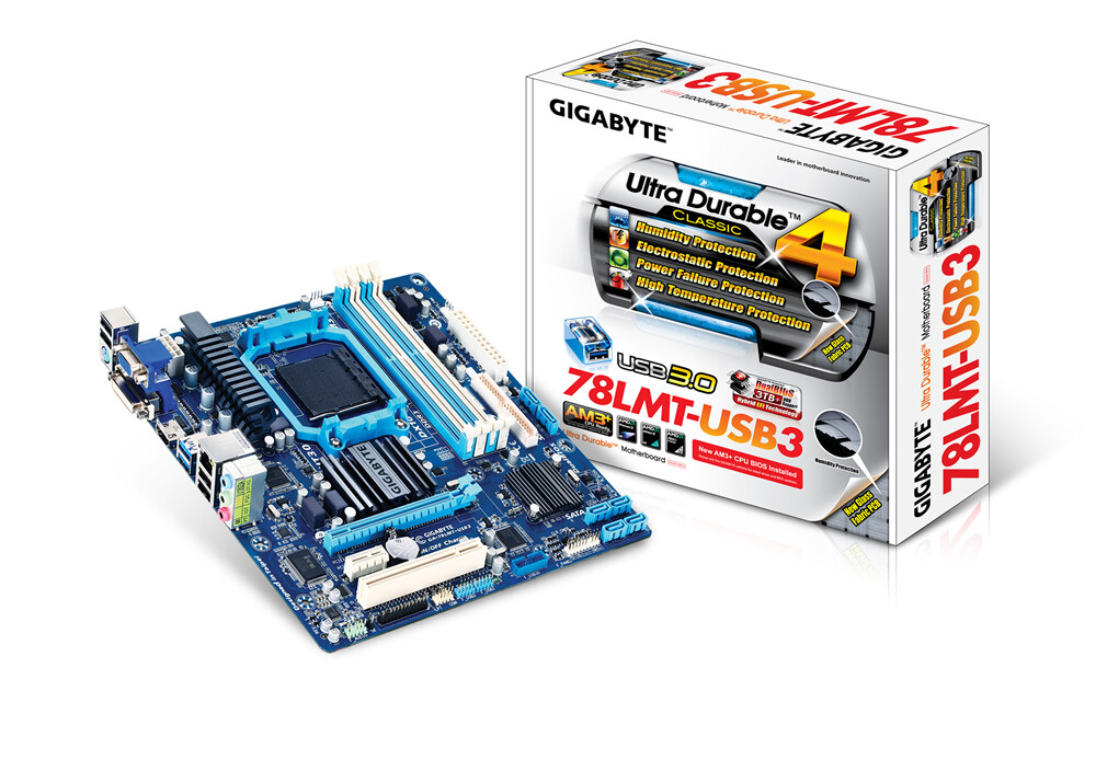

1question tho. From what I have read the bios mayweed an update is it better to do this before I install the os.
What makes you think the BIOS needs updating ?
Wouldn’t it make more sense to try tthe OS, then only mess with the BIOS if something doesn’t work, and the mobo website suggests the BIOS update may fix it ?
You should ONLY EVER update the BIOS if it’s 100% NECESSARY … getting the flash wrong can kill the motherboard, permanently.
See below This is why I asked Mark
OK, IF and only if you need to flash the BIOS … that board has Q-Flash … so you can update the BIOS from withing the BIOS itself
