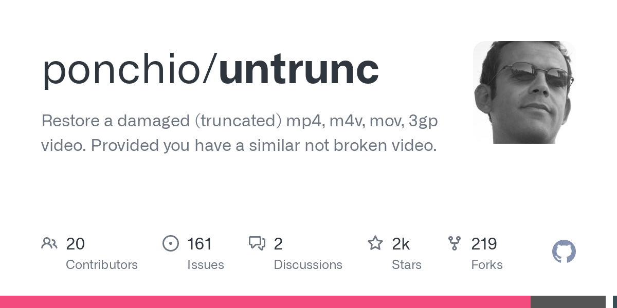

OK I pre-empted a little and installed untrunc by following the instructions here GitHub - ponchio/untrunc: Restore a damaged (truncated) mp4, m4v, mov, 3gp video. Provided you have a similar not broken video. which look exactly the same as your instructions.
But there’s a few things I don’t understand about the last command
./untrunc /path/to/working-video.m4v /path/to/broken-video.m4v
