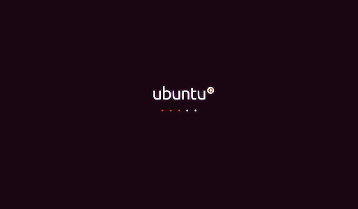

Well it sort of works… on start-up,
I.E:
It flashes on and off once, and then once I log in as myself, it turns on… so I need to tweak something, somewhere… :

Is it honestly that difficult to understand? It toggles itself on and off for a split second at the Ubuntu splash screen, with the script and when I log it, it turns itself automatically on… I don’t understand how the concept is hard to understand? ???
OK, I’ll elaborate
a) how does your picture of the Ubuntu loading screen help anyone understand that ?
b) so it’s fixed and doesn’t require “tweaking” ?
If it’s working … why does it need “tweaking” ? ← THIS is the bit you haven’t explained
So YES, I’d say it needs some explaining :o

It needs tweaking as I want it to come on and stay on AT the Ubuntu splash screen. Like I said, it comes on for a brief second whilst AT the UBUNTU SPLASH SCREEN. Still with me? Ok, good.
In order for it to stay on, it (the script you wrote which now resides in rc.local) needs “some tweaking”, which help enable me to get the desired result I’m looking for.
This way I can use bluetooth devices at start to control the laptop, coughAppleMagicMousecough. I’m picking such devices up on Tuesday, next week.
Surely that wasn’t TOO complicated to understand?
