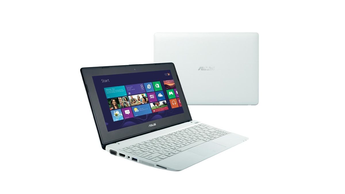

is this it

No that isn’t it, this is it:
https://www.amazon.co.uk/X102B-10-1-inch-Touchscreen-Laptop-Black/dp/B00FC55SVO
It says its a touch screen, but no idea what that means lol. It’s supposed to have 4GB RAM- how can I find that out?

Yes it has a standard SATA hard drive, so can take an SATA SSD … dunno how easy it’d be to fit though, those little things tend to need to be completely stripped down to get at the hard drive.
