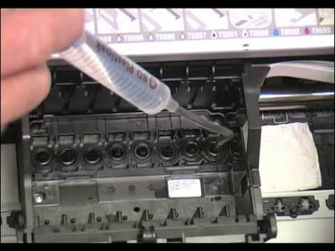

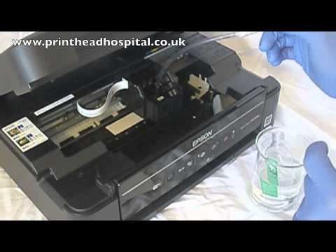

I found some very useful videos on unblocking Epson print heads:
It seems isopropyl alcohol is not the best solvent to use.

Yeah the difference is Epson printers use a different technology than most other makes (piezo print heads)
… their cartridges are purely ink tanks and don’t have the print head built in (that’s a permanent part of the printer) … this tended to make them slightly cheaper but their print heads more prone to blockages, specially with cheap inks.

I bought the recommended “Magic Bullet” cleaning kit and followed the video.
Re-inserting the cartridges resulted in the warning “Cannot recognise the following cartridges:” and listed all of them.
I assumed that I had got cleaning fluid on the electrical contacts so dried them; even leaving the cover open without the cartridges in place for an hour or so. But to little avail, except that only four are not recognised now.
EDIT 13:30: All but one cartridge recognised now so looks like it’s just cleaner fluid evaporating from the contacts.
EDIT 1345: Yep - that was the problem.
Advice for other Epson users:
  1. If you have to unblock the jets, do ensure that the cleaning fluid doesn’t get onto the closely-spaced contacts just forward of the jets - they are so close together that it takes ages to evaporate. Unlike the video, there appeared to be no fluid being syringed into the jet so I applied more pressure - which is when the pipe came off and sprayed fluid everywhere! I suggest just applying gentle pressure for a couple of minutes.
  2. Whilst waiting for the drying I put plastic covers over the jets so they didn’t dry out.
  3. I thoroughly recommend the “Magic Bullet” cleaning kit (Clean Print Heads with Magic Bullet Print Head Cleaner). The video and customer service are excellent.
