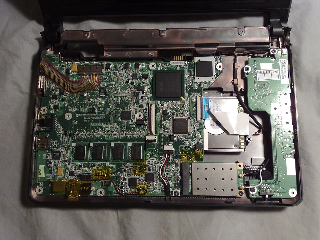

For a load of links to pages that will explain how to take apart the AA1, and how to fit either a new SSD or a PATA HDD, see here:
http://repair4laptop.org/disassembly_acer.html
or check out the pics and links here
BUT you will see that Acer have not made changing the SSD simple, it appears to require complete disassembly of the AA1, as there are no external covers for SSD or even memory expansion slot… So unless you are comfortable with taking your AA1 apart, either run it from a USB pendrive, or find someone with Laptop tech experience.

There’s a video on here somewhere which shows you how to dismantle an AA1

Oh ps you mentioned somewhere there was a vid re: replacing the SSD. Do you happen to have a link, or a link to that topic? Might as well start preparing for what is to come :slight_smile:
