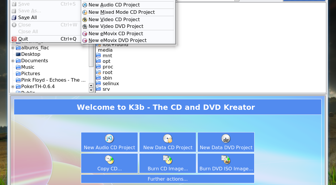

OK, now to create an ISO image of your XP installation CD …
I’m going to assume you have Brasero installed … if so -
First, insert the disc from which you want to make an ISO image. Wait until, and make sure, an icon for the disc appears on your desktop, indicating the disc has been read and mounted.
Next, open Brasero and select the Disc Copy function.
On the Copy CD/DVD dialog, change Select a disc to write to to ISO by clicking on the drop-down itself (not the properties button) and choosing Image file.
Click the Properties button and choose a name (such as WinXP.iso) and location for the output ISO image and then click Close.
Verify your settings and then click Start copy.
Mad Penguin suggests the ISO image should be stored at /var/lib/libvirt/images but if it won’t let you create it there, just create it in your Home folder and we’ll move it later.
Another option would be -
dd if=/dev/sr0 of=/path/to/where/you/want/to/save/WinXP.iso
where -
/dev/sr0 = your CD drive
But I wouldn’t advise using “dd” if you’re not comfortable with the command line :wink:
Another option would be to install and use AcetoneISO … then use the “Generate ISO from CD/DVD” option … see the pic here:
