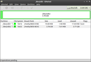

What problems are you having with Gparted ? … is it that the SD card isn’t recognised?, or is it that it won’t let you format the card?
If the card is recognised…
First make sure you have gparted and dosfstools installed:
sudo apt-get install gparted dosfstools
[END EDIT]
Fire up Gparted
  1. Select your SD card from the drop down menu (top right)… mine was /dev/sdb
  2. Right-click on any existing partitions, and select “Unmount” (make sure you have no open windows displaying the SD cards contents or it won’t let you unmount it)
  3. Right-click on any existing partitions, and select “Delete
  4. Right-click somewhere in the empty space and select “Add” and create a fat16 partition (of up to 4gb) starting at the beginning of the drive.
  5. If your card is bigger than 4gb, create a fat32 partition in the remainder of the free space.
  6. Click “Apply
  7. Close Gparted.
8.) Open a terminal, and run these commands
sudo su
echo -n BOOTDISK | dd bs=1 count=8 seek=64 of=/dev/sdb1
Be Aware - You may have to change the sdb1 part of the last command to whatever your fat16 partition is… if like mine the SD card was /dev/sdb, then sdb1 is correct, if on the other hand your card was /dev/sdc, then you will have to change the above command to have sdc1 at the end.
(if you’re unsure… fire gparted up again and have a look, the fat16 partition will show you)

Worked a treat.
