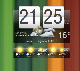

I’ve installed (well, tried to) and it shows my system stats and not the weather for my given location, also I typed in the commands to edit the files it says to edit and they were blank!!!
Any help on how to do this properly?

For the weather script, you need to register on http://weather.com to get a Partner ID and a License Key, and then add those to the conky script.
This is one of my petty hates about this type of conky script because I didn’t get my Partner ID or Lincese key from them. Currently someone I know is trying to convert the weather.com script to accuweather.com which is easier and better to use.
If you need anymore conky script be sure to let me know, as I run a lot of them.

Agreed that Conky is a PITA to configure, but I really don’t mind the ability to not be able to monitor other PC’s from one place, since I only ever monitor my own. If GKrellM is like Conky, can I do this: (see attachment)
Hmm … probably not (but I suppose it’s just a skin, so maybe it would be possible)… but nothing stopping you getting creative:
http://www.muhri.net/gkrellm/nav.php3?node=pic&show=13
But I take your point … I should have realised you’d want Speedometers

Right Pooky, I’ve configured the scripts for your location. (Your in Derby right?).
You can download the Conky scripts, from my dropbox:
http://dl.dropbox.com/u/37779798/conkyHTC.zip
Once you’ve downloaded the zip file, extract it. Then goto your home folder and create a folder called, .conky
After you make it, hit ctrl+h to show the hidden folders. Open a new window/tab to wherever you extracted the folder I gave you and copy the ".conkyForecast.config ; .conkyrc ; .vreme.templete & .images from there into the .conky folder. (you’ll need to hit ctrl+h again)
Once you’ve done this we’ll move on.
Done that so far, yes, I’m in Derby.
a) there are 3 errors in that .conkyrc file that you’ve put in your dropbox … they are talked about on the Webupd8 site
b) if you are using Gnome Shell … you need to change the window type/class too.
I’ve put a working (fixed for Gnome 3) .conkyrc in my dropbox here:
http://dl.dropbox.com/u/11876059/conkyrc.tar.gz
that is also set to Derby (UKXX0040) … and I’ve moved it to the middle of MY screen.
if you need to adjust the window position horizontally, play with the line:
gap_x 336
(default value was gap_x -20)
Can’t get it to shift vertically though :o
If you’re NOT using Gnome 3 (Shell) let me know.
Info on the window type/class modifications for Gnome 3, see here:
WHY IS GNOME 3 SO COMPLICATED! Apologies Pooky, never realised Gnome 3 had to modify the Windows type/class.
Anyway, once you’ve copied those files, you should now be able to get it to work by running:
conky -c ~/.conky/.conkyrc &
in Terminal.
Like Mark said, if you need to adjust the position of it, experiment with the gap_y ; gap_x numerical values.
