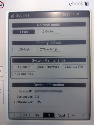

I have a ebook reader but it dosen’t show up as mounted I am trying to upgrade and put pdf files on, I need to unmount for the upgrade I have ubuntu 11.04 Please help

You need to upgrade the firmware on the 511EB to version 0.47 … it should then be detectable in Linux and OSX.
The links to the firmware on those pages no longer work … you need to go here:
http://www1.elonex.com/support/products/ebook/511_firmware_update.shtm
And be SURE to get the correct firmware for either the non-touchscreen model, or the touchscreen model.
You will need to do this on a Windows PC, and any firmware update to your Elonex 511EB is done AT YOUR OWN RISK.
(so don’t blame me if you end up “bricking” your ebook reader)
