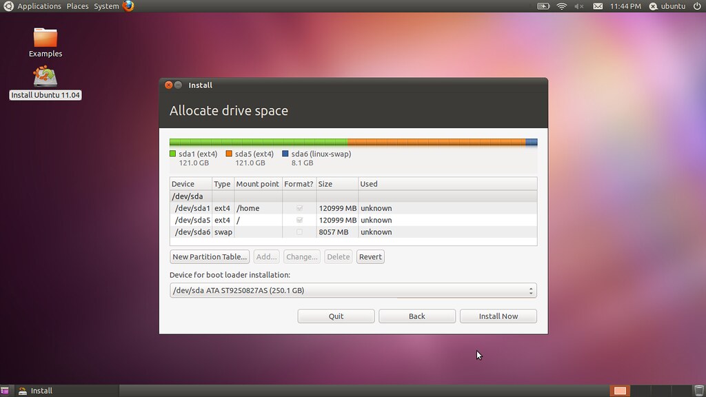

Ok due to some sort of superblock corruption/break-down, I’ve decided it was best to just do a complete reinstall of Natty. (2nd time install)
So far, I’ve talked to Mark and we came up with the idea that, splitting my drive would eliminate this happening again (well that’s the idea anyway). I have a 250gb installed in this laptop (I have many XD) so, we thought 2x 121GiB partitions, the main one mounted to “/home” instead of “/” and the second mounted to “/”. That would leave 8gb for a Linux-swap. So just to confirm I’ve done this right, here’s a screenshot.
Yep looks OK to me.
