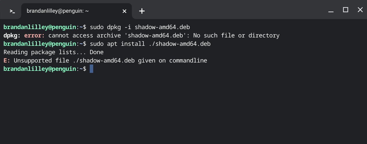

So I tried those commands and attached a screenshot, not sure what’s happening, this terminal stuff is quite confusing to me as I’ve never used it before.

Ok, so Linux has exactly the same concept of files and folders (directories) as Windows does. If you are in the same folder as your file, you can just reference the file name. If not you will need to reference the full file path.
As per above;
Note; this assumes you are logged in as root and the .deb file is in your current directory
If you are seeing an error that says;
No such file or directory
It would imply the file is not in your current directory. When you downloaded the file from the Internet, it will have stored it either in it’s default location, or it will have asked it where you want to store it. By default it will try to store in a folder called Downloads which is a sub-folder of where you are. So looking at what I can see so far, you would need;
sudo apt install ./Downloads/shadow-amd64.deb

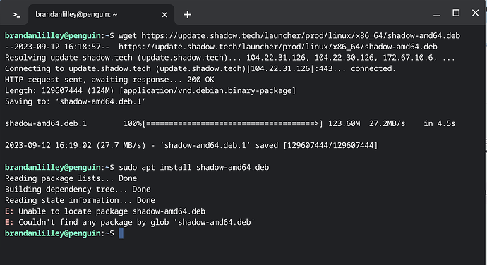

Ok, so the only thing that’s telling me from the documentation is that you’re running Debian under the hood rather than Ubuntu. If you can’t use “find”, try downloading again from within your terminal session;
wget https://update.shadow.tech/launcher/prod/linux/x86_64/shadow-amd64.deb
Then try the apt install command above.
I did the first step but what install command do I need to do?
sudo apt install shadow-amd64.deb
I have this message pop up?
Apologies, cut / paste issue on my part;
sudo apt install ./shadow-amd64.deb
apt is a bit fussy about local file paths and needs the leading dot + slash.

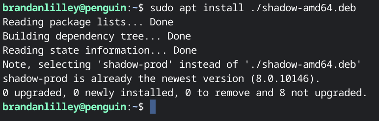

So I’ve got to this point, what next?
So what happens when you try to run it now?
The app isn’t even loading now, I’ve clicked on the app and nothing whatsoever…
Thinking; if you already had it installed via dpkg, try removing it and installing it again. It may not be installing the dependency list if it’s already installed.
