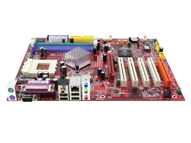

The board is a K7N2 with three memory slots and two 256MB modules. I 'phoned MrMemory for prices and discovered that a 1GB module is available. The lady assured me that customers have had no problems upgrading to 3GB (http://www.mrmemory.co.uk/memory-ram-upgrades/msi-micro-star/motherboard/ms-6570-k7n2?search=pr20213) but the the PC says the capacity is only 1.5GB:

Do you think I am limited to 1.5GB (3 x 0.5GB) or is it safe to buy 3 x 1GB?
That website suggests 3 memory slots, which is really weird! I don’t think I’ve ever seen an odd number of memory slots, apart from the one machine we had with SIMMs & 1 DIMM slot.
lshw should show which slots are occupied, and confirm how many there are (or, you could take the case off and have a look). I’d be inclined to buy either 1x1Gb, or 2x512Mb. Although installing more might be fine (the PC should ignore the extra RAM at BIOS level), it may not boot at all with the extra RAM.
I know the board well as I’ve replanted it into another case. There are indeed just two memory modules and three memory sockets, although one is of a different colour and slightly displaced - photo attached.
Can you explain why there might be a limit of 1.5G set by the BIOS? After all, 32bits should address about 10GB and lshw tells me that the PC supports PAE.
Every site I visit suggests the specs for max ram on that board are 3x1GB
I wouldn’t read too much into what lshw says … dmidecode and the memconf perl script suggest my AA1 can handle 4GB RAM (2x2GB)

one of the slots isn’t a slot as such it’s 512mb soldered to the board, but even that would suggest I could populate the slot with a 2GB SODIMM … wrong, it can only handle a 1GB SODIMM

In fact according to Crucial. ALL the K7N2 boards seem to support 3072MB

That’s a weird setup! My guess is that the blue slots are dual channel, and the green one is single channel (they look like the same pin arrangement, so both should take DDR). If my guess is right, in theory the machine should run better with just the blue slots populated and the green one free, but it’s not of significance if there’s only 512MB available. What did you order in the end?
If I’m right, you should move the stick in the green slot to the blue one, and the new stick into the green slot, some boards used to be funny about mixed sizes (i.e. not paired)
You probably are right … I remember a lot of boards with this setup when dual channelling RAM was new and RAM still relatively expensive (so people still tended to buy one single stick)
I guess it was cheaper for the board manufacturer than fitting 2 x dual channel configurations (as became more commonplace later) … even if the memory controller was up to dual channel (simply saving on the socket ?)
I guess they though “nobody will ever need more than 3 in anything but a server, right ?” … I know I did :wink:
