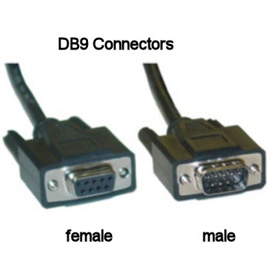

FYI, it’s not a “Serial” cable it’s a VGA cable, aka D-sub 15 because of the 15 pins
http://www.millermattson.com/blog/wp-content/uploads/2011/11/vid-VGA1.jpg
Serial cables (aka D-sub 9) only had 9 pins
Now you know who you’re dealing with. :-[ ;D
