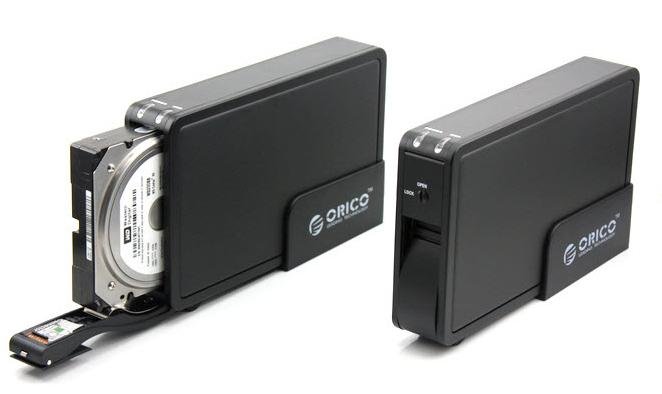

Have you considered just buying a HDD and a USB enclosure
Defenitely worth considering (as Mark said) the option of using your own HDD and a USB enclosure.
As for your existing drive, is it possible that it is suffering from power (or lack of) issues?
You may considere a twin USB connector lead to get more power.

a) a USB HDD enclosure will add about 5 mins (if that) … I mean you bung the HDD inside the enclosuse, and plug it in
b) an enclosure will allow you at a later date to remove the HDD from your current external HDD and test it in the enclosure
You do understand what we mean by an enclosure ? … just an external HDD without an HDD in it (you fit your own.
This kinda thing:-
