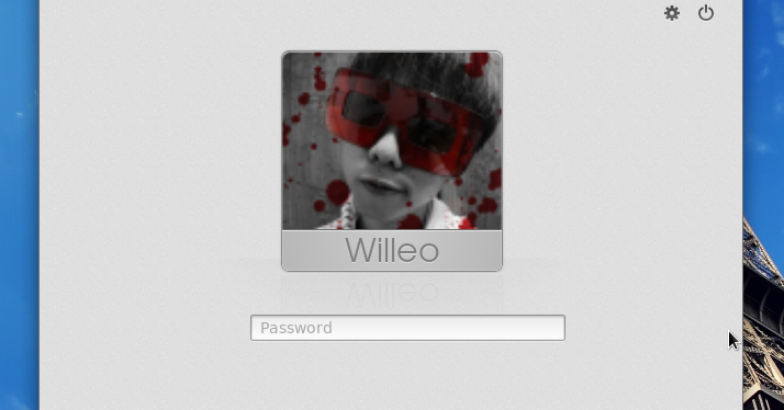

I installed unity-greeter for lightdm, and changed the background color and removed those annoying dots (as well as the ubuntu branding).
Now the problem is, the font up in the top bar is really dark. I’ve googled around a decent amount, but I couldn’t find anything on changing it.
Also what happens is it suspends…the lights on the front show that it’s suspended…but when I reopen the lid, the screen doesn’t turn back on. It stays black without even the lighter colored black that it shows when it’s on.

@ donwatson
http://linuxforums.org.uk/index.php?topic=9782.msg76394#msg76394
See this posting … or at least the second half of it.
A) I’m not sure I can help with the font colour … it may be sset by the default gtk theme, but I have no idea how you would change that in LXDE.
I suppose you could look into another greeter, such as the Elementary OS pantheon-greeter … which has a nice digital clock on it too, but isn’t quite finished yet … I couldn’t get it to display my background image (apparently a known bug that’s being worked on) … tiz nice though, even with a black background
Click on the second image at this link, to see how it should look, if you can get the background image to work -
B) Is the PC resuming from suspend, but just without the backlight coming on ? … you can test this by shining a torch at the LCD monitor and checking if there’s a picture there, but it’s not light by the backlight.
It appears this is a problem in the with how the HPET (high precision event timer) handles event triggers in some deep CPU c-states on your hardware.
According to the lower postings there, it’s supposed to be fixed in kernel 3.5 … so maybe you’d like to try the 3.5 kernel from Ubuntu 12.10 … or the patched 3.2 kernel linked from that bug report … or the nohpet kernel boot parameter.
