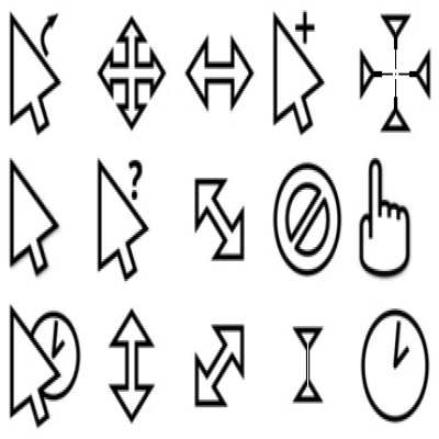

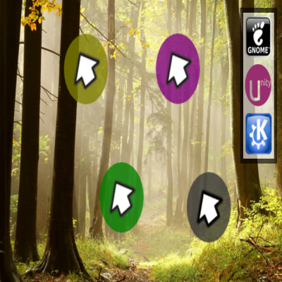

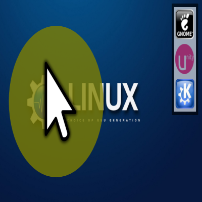

Hi pooky
I tried out of curiosity increasing my cursor size also without any luck, but I had a look on gnome-look.org and found a few themes, for some reason they only work inside an application but maybe that can be tweaked, personally i found the first 2 a bit annoying and not something I would use but they might be useful for someone with poor eyesight, the last one is possibly more what you’re looking for, no harm in giving it a try
or you can try this one, it just puts a semi transparent circle around the cursor, but again it only seems to work in applications
and finally this one, it just gives a large finger pointer, probably more what you’re looking for
If any of the above themes are any use to you it is possible to make them permanent ie to work on desktop and whitespace
