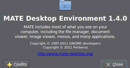

Maybe Mint 13/14 with the MATE desktop would be a better bet ? … or maybe not … maybe you could test it on a LiveUSB or VM ?
Actually I think you can install the MATE desktop on Ubuntu 12.04 from a PPA
[EDIT 2]
Yeh, you can :slight_smile: … according to this:-
You just need to run these commands in sequence:
sudo add-apt-repository "deb http://packages.mate-desktop.org/repo/ubuntu precise main"
sudo apt-get update
sudo apt-get install mate-archive-keyring
sudo apt-get update
sudo apt-get install mate-core
sudo apt-get install mate-desktop-environment
