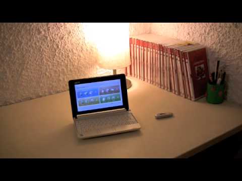

a) using another PC to create a USB stick installer, then attempting an install to the AA1 from the USB stick… as shown in this video:-
b) using the external optical drive (connected to another PC), and attempting to copy the ENTIRE contents of the DVD to a folder on that PC… you can delete it afterwards, this is just to test the optical drive can read the entire disk.
Personally I’d go with a) as even if the optical drive can read the DVD, it doesn’t necessarily mean it can install from it.

I’ve tested out option (b) and all the files copied fine onto my boyfriend’s computer, so that suggests the disc and the optical drive are OK.
Apparently option (a) risks reformatting my boyfriend’s computer if I get it wrong. He needs it for work so we’re not too keen on that idea! Would it tell us anything useful if I tried using my own faulty AA1 to create the USB stick installer?
