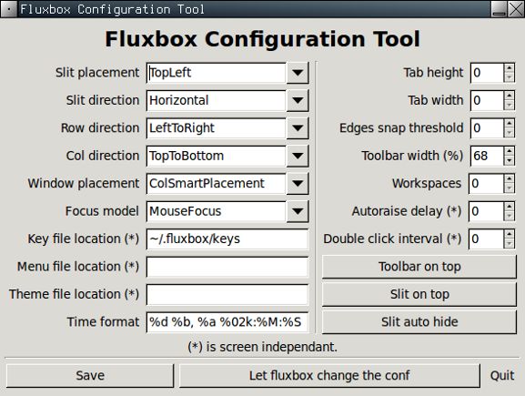

There is a GUI menu editor in fluxbox (you can use to remove the install option) as can be seen at the following website, it should also anwser your other questions -
The fluxmenu menu editor is normally installed by default in most fluxbox editions, but if it isn’t, it is part of the fluxconf package that can be installed through the synaptic package manager.
The fluxbox menu can also be edited manually, as the menus are stored in a plain text file -
mousepad ~/.fluxbox/menu
Instructions here -
