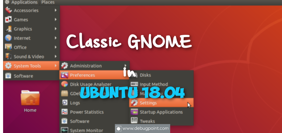

Although Ubuntu 18 is Gnome-based it still has the Unity-like desktop. Before I install it, I’d like to check with you, please, that I can still install the Gnome Session Flashback (Classic View) in the normal way. I don’t know anyone who likes Unity - all my elderly friends prefer Classic View, too, as it’s very straightforward.
Many thanks as usual, Mark.
Yep…
It’s as simple as
sudo apt update
sudo apt install gnome-session-flashback
then choosing it from the login screen
