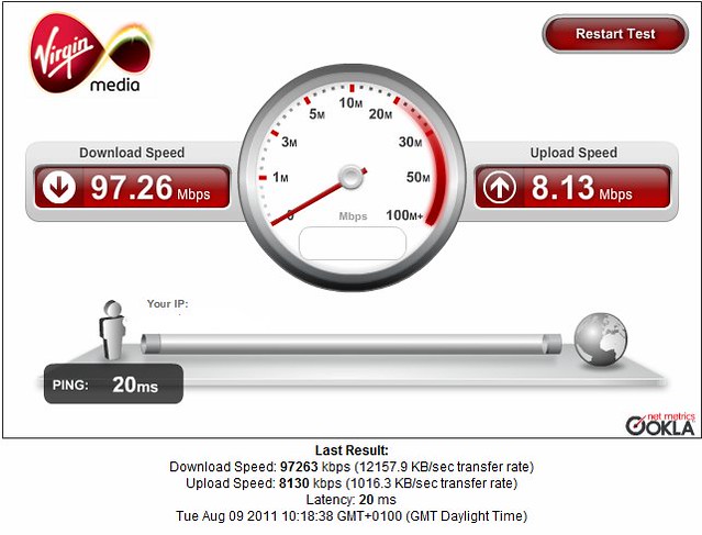

I got this for the very first test when I was downstairs.
http://farm7.static.flickr.com/6203/6050602642_f8e73667b1_z.jpg
I then did a further 10 tests. 5 of them downstairs beside the router, and 5 in my room.
On average, I get somewhere between 40-44.7Mbps D/L and a stable 9.1Mbps upload. (An improvement for upload.)
Not much of an improvement however, it is now more stable and consistant. In my room I’m still getting around the average, which I wasn’t before, and let me guess the bad news. 11.10 isn’t going to support it :frowning: ?
