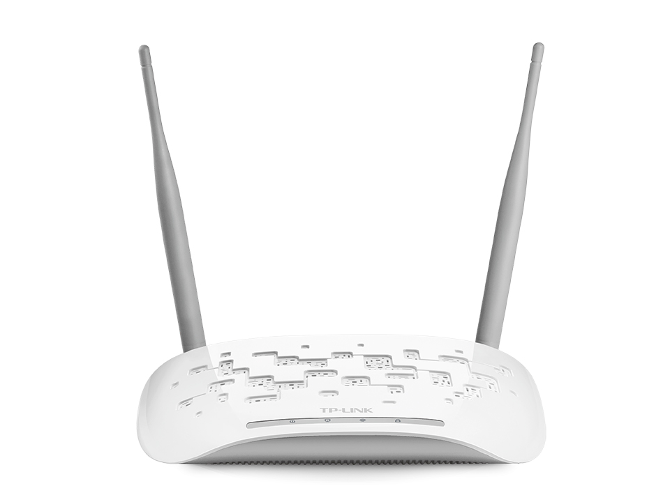

Virgin Superhub and TP Link TL-WA810ND
Just wanted to check the settings for this combination, as you might have guessed I’ve gone out and bought an AP, I just wanted to run a few questions by you in case I need to make amendments -
Just set this up and it’s working, the VM superhub is connected to my desktop, the AP is connected to that via ethernet, seesm to be working as it should and my android’s connected fine just now, I’ll try the laptop in the shed in a minute! So . . . . . .
  1. Do I need to put the superhub into modem mode? Any point in it broadcasting if I’m going to connect to the AP or doesn’t it matter?
  2. The SH is on channel 6, I changed the AP to this as well thinking that was the sensible thing to do?
  3. the ‘Mode’ has options, it’s on 11bgn mixed at the moment, is it better just on ‘n’ ? or no difference?
  4. I changed the band to 5ghz as opposed to 2.4, will this help?
  5. Do I need to enable DHCP on the AP and change some settings, I can’t print from my android now, no route to host ? It’s currently set as disabled.

Is this TP-Link doodad just a wireless access point … or is it a router/bridge in its own right
Assuming it’s just an access point
  1. NO … the SH will still be doing the LAN routing … but you should turn off it’s wireless.
  2. NO they should NOT be on the same channel … but as you need to turn off wireless on the SH it doesn’t matter
  3. leave it as b/g/n unless you’re 100% sure you’re not going to connect with anything other than wireless n
  4. If that didn’t kill your wireless network for most devices I’m guessing enabling the 5Ghz band does NOT disable 2.4 … more that both are enabled at the same time (as is normal) … you need wireless adapters capable of 5Ghz to make use of it.
  5. I’d say NO … let the superhub take care of all IP assignment
If the TP-Link is a router (which a quick google suggests it’s not) … then non of what I just said applies :slight_smile:
Just read the website here:
and noticed this
Supports multiple operation modes: Access Point, Multi-SSID, Client, Universal/WDS Repeater, Bridge with AP
which mode have you got it set to ?

You DON’T want to set the SH to Modem Mode … as it’s still going to be doing the routing and DHCP … all you want to do is disable the wireless in the SH.

If you turn off everything … then turn on the SH, then once that’s up turn on the Access point
What IP addresses are handed out to any PC’s on the wireless network ?
My IP’s on other devices all seem to be the same as before . . . . I have 192.168.0.10 on the laptop, 0.12 on the android 0.11 as my desktop address and the TP link is 192.168.0.254
Have you associated the printer with the new wireless access point and key ?
You might want to turn off the 5Ghz band for now … you know everything works on 2.4Ghz … and I vaguely remember reading 5Ghz can confuse some Epson printers (I could be wrong here … but there’s no reason to complicate things more at this point)
I haven’t done anything specific no, more to the point, I don’t remember trying to log into it before I changed the SH to 5 ghz so I’ll change it back, good enough chance that’s what it is …
Edit: No . . . . . didn’t help, still can’t see/connect to the printer . . .
What I mean is did you (in the printer control panel) associate the Printer with the new wireless access point ?
or is the printer still trying to associate with the SH.
