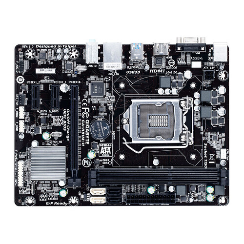

Gigabyte H81M-H Motherboard

At the moment I’m assuming this is coming from the EFI BIOS and the onboard graphics adapter Vs your add in nVidai card.
Is there any way to set the EFI BIOS to “legacy BIOS” mode … and/or disable the onboard graphics card in the BIOS ?
If not, I’ll post how to try “nomodeset”
See page 24 here:
enable CSM Support
and set “Boot Mode Selection” to “Legacy Only”
then see page 26
and disable “Intel Processor Graphics”
Ok, I think I just changed something in BIOS from UEFI & Legacy to Legacy Only, after which I tried booting from LiveCD again. This time it started a Linux Mint display with a boot countdown. After that I’m shown a white screen with a blinking cursor at the top left. Keys are unresponsive and it seems stuck there.
See the edit above … try disabling the “Intel Processor Graphics” in the EFI BIOS too.
Oh wow! Just disabled the Intel Graphics and it started to install! Now I have Linux!! Thank you SO much for all of your help.
