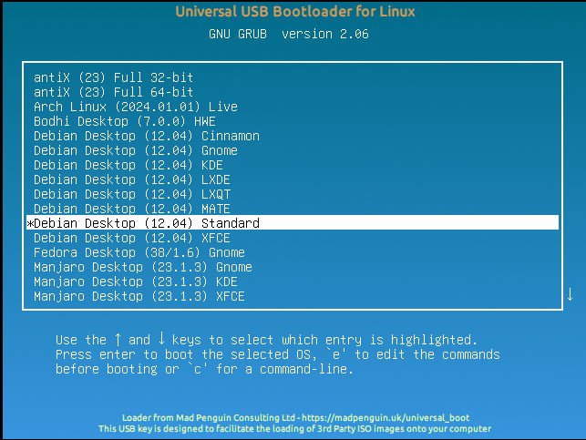

  1. Boot your computer from the USB Key
  2. Select the Debian Standard instance (boots to CLI)

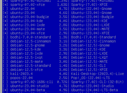

  1. Use the down cursor to navigate to Ubuntu 22.04
  2. Press the space bar to un-select Ubuntu 22.04 (remove the asterisk)
  3. Use the down cursor to navigate to Ubuntu 24.04 Beta
  4. Press the space bar to select Ubuntu 24.04 (add the asterisk)
Screenshot from 2024-02-16 13-09-36
  1. Hit the TAB key to highlight OK, then press RETURN.

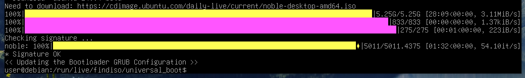

  2. You will be prompted with the ISO images to remove and to install, press the left arrow to highlight YES then press RETURN.
  3. The image should now start downloading, a progress bar will indicate how things are going and estimate how long the download will take. This estimate is indicative but can be wildly unreliable, but at this point you should probably go for a coffee … (it is subject to your Internet connection AND the speed of your USB port)
  • I’m testing this in a virtual Machine on a standard broadband connection, the overall time for this download / write to key (4.9G) was about 30 mins.
If you have a fast Internet connection, then the download will have completed BEFORE the ISO has been completely written to the USB key. Make sure you so a sync before rebooting.

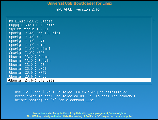

… when the menu appears, scroll down …
Screenshot from 2024-02-16 13-57-48

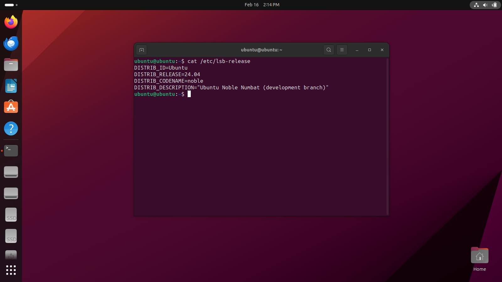

  1. With any luck, you should find yourself running the latest Ubuntu Beta! (note; this particular image is pretty big at nearly 5G, so it takes a little while to boot…)
