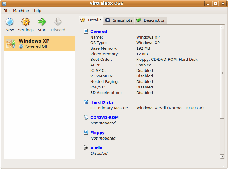

OK, read this:
Give the XP install about 1GB - 1.5GB RAM (so you have plenty left for the Ubuntu host)
(you can adjust this later after the install … ie. if you install more RAM … as you can with all other VM settings)
And accept the defaults for other things like the virtual HDD … it will say it’s only an 8GB HDD, but it dynamically adjusts its size (as long as you accept the defaults).
Any questions … feel free to ask :slight_smile:
And remember, NOTHING you do during the install of XP in Virtualbox is being written to your “actual” Linux HDD, it’s ALL being done to the “virtual” machine/HDD file … so worst case scenario, delete the XP VM and start again.
What I’m saying is nothing you do in Virtualbox is likely to hurt your Linux install :wink:
Once you have XP installed in a VM, let us know, as it will be a good idea to install “Guest Additions” inside the Windows VM.
OK, I’ll have a good read and get started. If I have any problems, I’ll give you a shout.
Cheers.
No problem … it really is easy … , after the initial few questions about setting up the VM virtual hardware, it’s pretty much just a normal XP install :slight_smile:
Here’s another link you might want to look at:
http://www.tweakhound.com/virtualbox/vb4page3.html
But as I said, other than the amount of RAM you assign to the VM … it’s probably best to just accept the defaults and keep clicking “Next” … nearly all the other settings can be adjusted after XP is installed, if you wish.
Not sure what to do with the Hard Drive setting?
